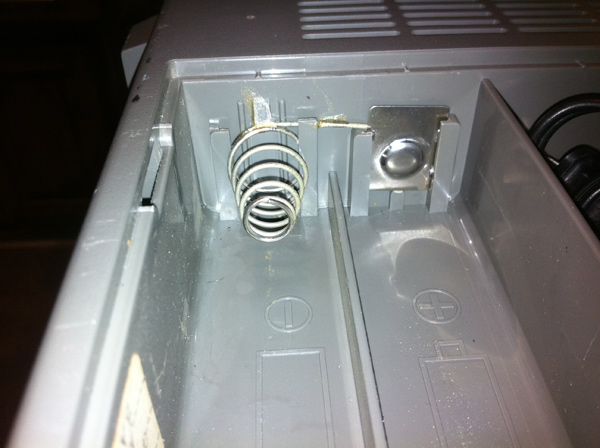

it does not have an ac/dc switch. here are the pics of the battery connections, they look adequate to me... tell me if I'm wrong. Now that you've mentioned it, I noticed a small little switch that presses in when you plug in the AC, and it releases when i unplug it. When I manually press in the switch and release it when the batteries are in , I hear a small pop of the speakers. So I'm guessing this is how it switches to batteries when it's unplugged. Any suggestions how to remedy this issue? Your answers are appreciated. :-)

The switch in the socket shuts ac power and allows dc power (batteries) to take over so the switch may be dirty or corroded causing loss of battery power...1st does ac power work if so you can try regular d cell batteries if they fail then the switch needs to be cleaned..You can try to get some spray deoxit from electronics store and spraying switch then work the switch by plugging cord into socket of bbx and removing 30 or more times...After you have exhausted this and its still unworkable you can try back to go further ;-) :thumbsup:
