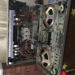

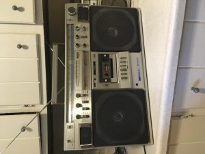

Hey guys! Brand new here, even though I’ve been collecting for a couple years now. It’s not a large collection by any means (Panasonic RX-5080, RX-5150, a JVC PC-55, and now this Prosonic)
When I bought this one the left speaker didn’t work, but with some repetitive toggling of the line in/radio/tape selector I can persuade it to. Play function doesn’t work on the tape deck, but it does FF and REW. One thing I noticed was the REC. light was always on, with the button in or not, and what sounded like a motor running whenever it had AC power or batteries installed. I reached in to physically turn the capstan myself counter clockwise which made a click and the REC. light finally turned off. Now when I press play I can hear the same motor start and can stop it by, you guessed it, pressing stop. The head and pinch roller won’t raise up to engage a tape though.
In your opinions does this just sound like a belt problem? Or is it more mechanical than that? Will slowly and cautiously try to take it apart today. The only other box I’ve opened up is the RX-5150, which also has a sick deck. The play speeds fluctuate, usually starting at a normal speed and getting slower and slower while periodically screeching? Anyways, that’s a whole other post I’ll make another time. Pictures below!

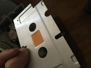

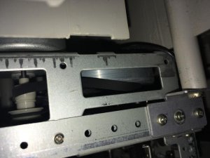

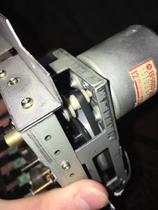

Exciting update! Grabbed some bits and bobs for the beginnings of a repair kit today. Got the thing apart, cleaned the line in/radio/tape contact with 99% isopropyl so my left speaker works again without 'encouragement'. Also cleaned the crud out of the deck, at least the visible parts anyways. I tried manually lifting the assembly up to emulate engaging a tape, and it starts to play! But the capstan wouldn't turn without me physically moving it. Upon further inspection and to my surprise, all the belts are intact! The bigger flat belt just seems to have slipped off the large heavy wheel which controls the capstan! I will tackle disassembly of the whole deck tomorrow... seems kind of daunting. SO GLAD I DON'T NEED NEW BELTS. Pics below.

I'm glad you're making progress but if that belt slipped off it's probably because it was too loose and means it needs a new one.

I took apart the tape deck today. The belt drive seat that came out of the motor was misaligned, much too far out which didn't line up with the capstan wheel. I pushed it back into the motor and now have put the belt back on. It's working great now! I also used some 3 in 1 oil on the capstan wheel. Plays wonderfully. I think I lucked out more than anything with the belts. Next up is that faulty motor on my 5150.
