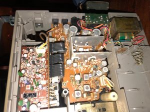

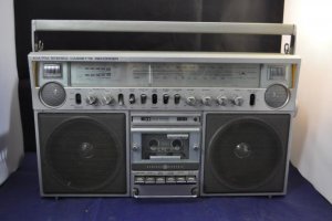

I have this great little box and I've completely cleaned and polished it. It looks brand new. The problem is that when I run it on either AC or DC after about 3 minutes of perfect play, the sound starts to fizzle out and then there's nothing. If I turn it off and let it rest for a few minutes and turn it back on, it runs for about 3 minutes perfectly and then fizzles out to nothing. This happens wether or not I'm using the tape deck, radio or line-in. It's so consistent that I've thought that it's a component going out when it gets hot.
Interestingly, the sound meter still registers sound even though there's nothing coming out of the speakers.
What I've done:
1. Cleaned all pots and switches (about 4 times)
2. I've hit every solder point for capacitors on the power/sound board to be sure that they are solid.
3. Checked every wire connector to be sure that everything's connected.
I have no idea if the problem IS with that particular board, but it was a place to start. I'm not an electronics tech, so beyond that Im lost.
Does anyone have any idea what this could be? I really love this little box and want to keep it alive into the next century!
I see that I posted the picture from before I fixed it up. It was a wreck, but now it looks like new :)

Clean the jacks using whatever method is available to you. If it’s open, you have many options. If they are sealed or Inaccessible from inside, then spray deoxit into hole & work the jack with an appropriate plug.
Freeze spray is available in electronics stores or online. Compressed air spray is available from the same or from computer supply stores. Even Costco sells them. However, compressed air is not as effective as freeze spray for troubleshooting purposes.
You would spray the amp chips, which would be the chips screwed into the aluminum heat sink. The brass thing is the AC transformer. However, again I don’t think the amp is the problem because you have 2 chips, one for each channel and it’s unlikely they both go bad together.
Other components could suffer from overheating issues too such as zener diodes, etc. You may be able to isolate the bad component if sound is restored after you spray it.
BTW, a dirty record bar like others mentioned can also be the problem. It looks like a rectangular bar, usually around 2 to 4” long. There is a plastic spring loaded actuator at one end. Spray deoxit into one end, hopefully so solvent works it’s way down it internally via gravity, then work the plunger vigorously, 20 times or more, depending on how dirty it is.

Thanks for the info. I'll see what I can do. I imagine the heat sink is the aluminum three sided rectangular wall that's just to the right of the three black cables. That's what I thought it was. And I'm not sure what "the chips that are screwed into it" are, but I'm guessing that the 4 screws (two on each long side) are the chips or are the chips the components inside this heat sink area? The components inside the ehat sink area are not screwed into the aluminum wall, just so you know. I'll have to break into that box again and see what I can find.
Sorry for all the questions, but I do want to be sure I'm doing this right. If there's a chance to fix it, that would be great!

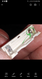

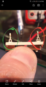

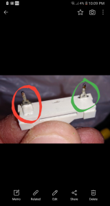

Hello everyone, i'm new in the forum but i lately got the boombox bug and i'm somehow handy working with electronics (i was more into vintage stereo components before).
I know it's a old thread but maybe my experience can help someone else, so i figured i would post.
This problem is due (at least in my case) to a damaged selector switch.
Upon unsoldering it (quite easy task in this boombox actually) i noticed that one of the pins was basically melted down, losing its ability to make proper contact.
Probably this is due to the switch almost constantly set in the same position and the electric current warming it up.
I tried pushing it back but that's impossible: the solution i found was soldering a drop of solder on top of the little metal round plate, to make it sticking up higher so to be able to somehow reach the "original" position and make a good contact when that side of the switch was selected.
Mounted back the switch, resoldered and problem fixed.
I added some pics, the first showing the solution, the others two showing the problem.
P.S.: when you open the switch box you will most likely break the little plastic tab that holds it together: i did, but i just crazy glued it back with no problems (it's not really necassary because when you solder it back it's forced to stay in place anyway).
