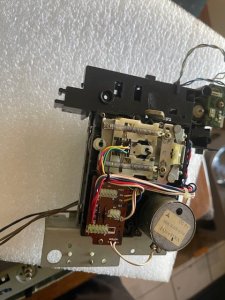

I just opened up the deck section to replace belts and don't have a diagram for the belt path.

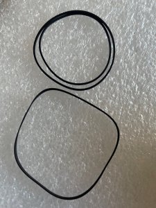

I think there are 3 belts. One is the mail flat belt to the flywheel and two others, where one is slightly smaller in length.
The motor got a double pulley one for the flat and the other for a medium square belt.
I tried several possibilities for the belt path but cannot figure it out.
One metal panel fell off from the bottom and I need to put it back there in such a way that it won't short any connections on the main PC board solder joints.

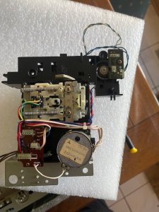

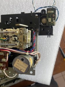

I already had belts.
In the picture below we can clearly see the top cover with motor pulley and the inside part with the flywheel and 2 pulleys.
The longer square belt must be the counter belt and the other one goes to the farthest pulley from the small motor pulley wrapping the side of the other pulley in its path.
That is all I can think of now.
Is that right?

Successfully replaced the belts and all.
The pinch roller I had was a little small, so I have to put another one.
Pretty much like the RX5350 when you take the face cover off, the VUs gets fully exposed, and one has to be extra careful not to damage it. I made a plastic cover and placed it over while working.
