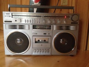

New project, GE 5259a tape repair
Dec 3, 2010
5,763
275
Chicago, IL
Like Bill mentioned the sound quality issue is due to a bad pinch roller. The rubber on the pinch roller got hardened and is not catching the tape pressed when against the captain. If the rubber is not looking that bad, gently sand it in play mode without a tape - taking extra care not to rub on any other parts except the pinch roller rubber. I would roll a 400 grit emery paper on a thin tongue depressor wood piece or an ice cream handle and hod it against the pinch roller and make it slightly rough.
If the rubber is so hard, then we might have to replace it. Hardened rubber won't grab the tape and will cause distorted sound.
A new pinch roller would make a world of difference.
