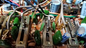

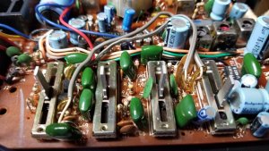

i was messing around with it and found that i could get audio from R32 & R33 on the board
but maybe going thru the IC would be better?
and i also wonder how to disable the radio so there is no static

Since there is no wiring diagram it is a bit difficult to determine the correct points.
You may need to desolder these resistors 32 and 33 and connect the line input there.
Can you take a picture with the location of these resistors?

I desoldered pins 4&5 on LA3361 and soldered the wires from the audio cable to it. It seems to be working.
Yes, if there is no noise, this is the right solution.
You can do one more thing - to disconnect pin 1 of LA3361, will stop powering it.
