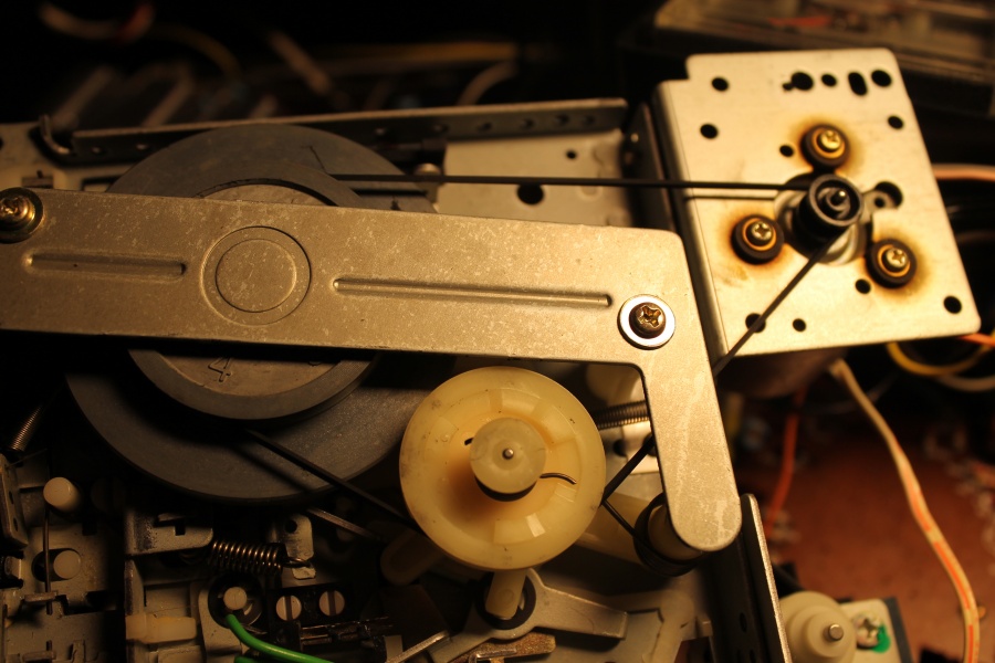

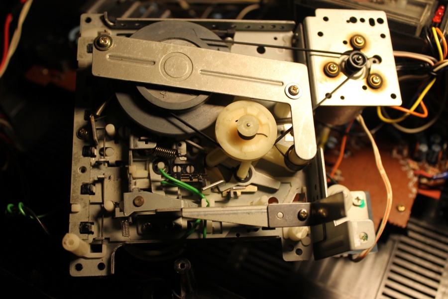

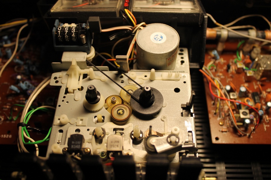

Pulled the crown all apart tonight, pulled the deck assembly out and found a whole bunch of gooey stuff wrapped around one of the wheels, im guessing thats where the belts have gone and why it doesn't work anymore :-/
took afew pics of the deck, where all the goo is, is that the deck motor? im unsure of what parts are which. if so does that mean the motor could be stuffed? or could it be cleaned of all the goo? also since there are no belts on the underside which pulleys do the belts run on?
ive got a pic of the top side aswell.

All of that goo is indeed the belt vkboy. You'll have to clean all that off entirely for a new belt to run properly.
I expect the belt should go around where all the goo is at that end then run around the smaller section of the big silver wheel in your photo.
It may need other belts tho, dunno coz i've never rebelted one. Some radios have 1 belt and some have up to 4. Depends on the manufacturer.
Someone will chime in with more info i'm sure........ :-)

This unit is tricky to rebelt because there are 2 ways to run belts and of course one way don't work right. So test before you put back together ;-)

do any of you guys know how mny belts this should have? from looking it only looks like it should have the one belt, where would i get replacement belts for it?
also what should i use to clean up all the goo stuff?

I can't remember sizes and I don't know where you would get belts but there are 2 belts. Easy way to measure is with small sting around pulleys then measure and deduct about 5%.
You can clean all old belts off with rubbing alcohol and cotton swabs. Here is a pic of another members 850 deck :-)

i haven't got a 3rd pulley like that 850 and the big silver wheel on mine only has a slot for 1 belt, it doesn't have that extra little wheel on the top :'-( , confused :sad:
i got all the gooey old belt cleaned off atleast, just need to suss out the belt situation. i guess i could always just try it with an elastic band or something and see if it works that way with the 1 belt, as i don't see how my system will run 2 belts.
You can actually manually test it with a rubber band by pressing play, ff and Rew while manually spinning in right direction and watch capstan and reels spin ;)
