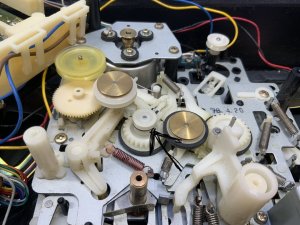

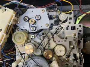

Hi I have just bought a Hitachi TRK-5280e The radio works fine but the tape wouldn’t play so I opened it up and found that the belts have been melted from age cleaned up put new belts on but won’t drive the main sprocket for the tape to wind up I don’t know what I’m doing wrong not very good at writing please see pictures

Belt path looks good based on the picture attached. Somehow the contact wheel linked to the gear system is not moving and catching it to engage tape transport mechanism.
Locate the wheel linked to the tape take up reel axle. Press play and see how these wheels are engaged and check what is limiting the movement. There are contact wheels with gears move back and forth for each transport mechanism to activate it.

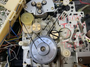

With all belts in place turn the flywheel counter clockwise. In some cases it will reset the deck and all will work fine!
Other experienced members will have better suggestions.

Possibly the rubber tires need to be cleaned along with whatever is supposed to drive them, they may be slipping.
It looks like there's quite a bit of dust in and around that area.
