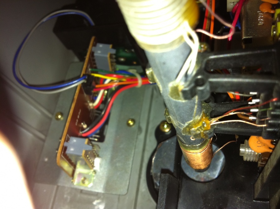

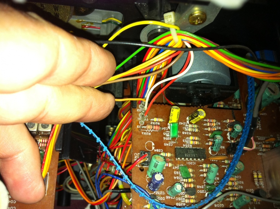

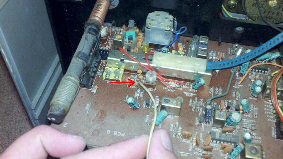

its coming out from where the picture is. the loose end isnt shown. yes its white. so its connected on the circuit board beneath the power and alarm switches. in between the 3 orange resistors? dont know the terms? im a newbie.

You mean the 3 brown caps on the tuner board :-O :-O :thumbsup: I do not have a wire coming out from that point :hmmm: :hmmm: sorry :sadno:

How long is the wire :huh: :huh: Is you tuner working 100%, If so just tape it up if you cant figure it out for now ;-)

its over 18" long and the radio works fine. who knows?

Just to BUMP this thread, that white wire from the tuner board goes to the back side of the external antenna screw post on the back case. This is ONLY on the Clairtone AKA of this boombox. I have been inside the Helix and the Conion as well and neither has the extra white wire. Maybe because Canada (where Clairtone was sold) has a wide area of communities spread out really far, this maybe boosts radio signal?
