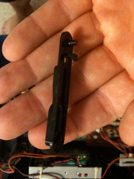

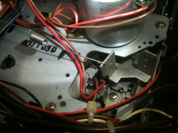

And just in case anyone has some advice from working on this model, here's what I see after just taking the back off. Any advice would be greatly appreciated. I'm most likely not diggin in further without my brother comes over. He went to electronic repair school back in the day when he'd be fixing VCRs and Radios everyday.
Lower Deck (tape 1) - The play head, pinch roller and that assembly seem to be stuck 'up' in the play position. Roller is pressed right against the capstan and I can't get it to release. That's the way I got it. When you hit play/ff/rw, nothing spins, and of course I can't even get a tape in there as it's in that playing position. I can see the larger flat belt spinning that's connected to the motor, but that's all I see moving from the back. The smaller belt (the SPS 8.9 i believe as my measurement was about that) was broken and just hangin around the area when I opened it up. So obviously I need to replace that belt, but not sure what might be not letting it get out of the 'play' position. And then there's 'mystery' part that was kinda just stuck at the bottom of the case when I opened it up. Maybe this has something to do with the position issue as it looks like something that could slide and hold something in position. And I have no idea if the 2 tecks are tied in together were having the lower one stuck in position might affect the top one.
The flat belt is spinning, but this is also where I found the torn smaller belt. Not sure what all that alone would kill
Mystery loose part that was to the left (from backview) of the lower deck
Top Deck (tape 2) - Accepts the tape, and I see the gold looking metal part spinning (right below the motor I believe), but I think it might be spinning freely without the belt or other any other pieces moving. And the FF/RW have no response with any movement beyond the buttons. And not sure what it should look like when pressing the PROG button, but that seems to do nothing. It's currently just lit on the 'reverse' play light.

M and S is medium and small for the width. The bottom deck is not tied in with top deck but the bottom deck is fully automatic, so you need a working belt on it in order for it to release back into s stopped position. If you have deck access you may be able to turn the wheel by hand so it can finish and go back to a stopped position :thumbsup: the black part looks to be a slide maybe for record or pause control. Maybe someone who has actually worked on this deck can chime in to say exactly what it's for :hmmm: :-D good luck ;-)
hemiguy2006
May 5, 2009
2,408
151
63
52
That mystery piece is for the bottom cassette storage drawer there should be a spring with that as well.
This is what keeps the drawer closed and also releases it when you press the drawer.
If you are missing the bottom drawer dont worry about it.
I am missing that part on mine :sad:
I imagine you have this figured out by now? I recently got ahold of one of these boxes and am almost done with a clean/refurbish. I found that the belt you are seeing/saw spinning is what raises/lowers the play mechanism into place. There is a small switch on the other side that turns the motor driving that entire contraption on and off. It consists of two copper blades with contacts on the end. They disconnect once the "tray" or whatever you want to call it is in place. I can provide a much more detailed description if you haven't gotten this taken care of?
