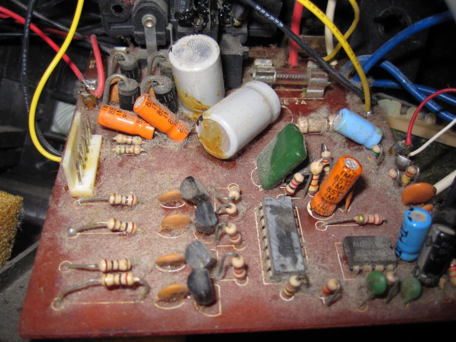

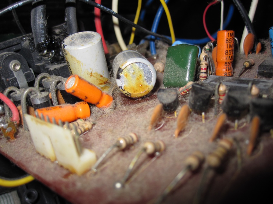

Board that handles the power input from the mains and battery. The orange goop on the two large caps is what I was describing above.

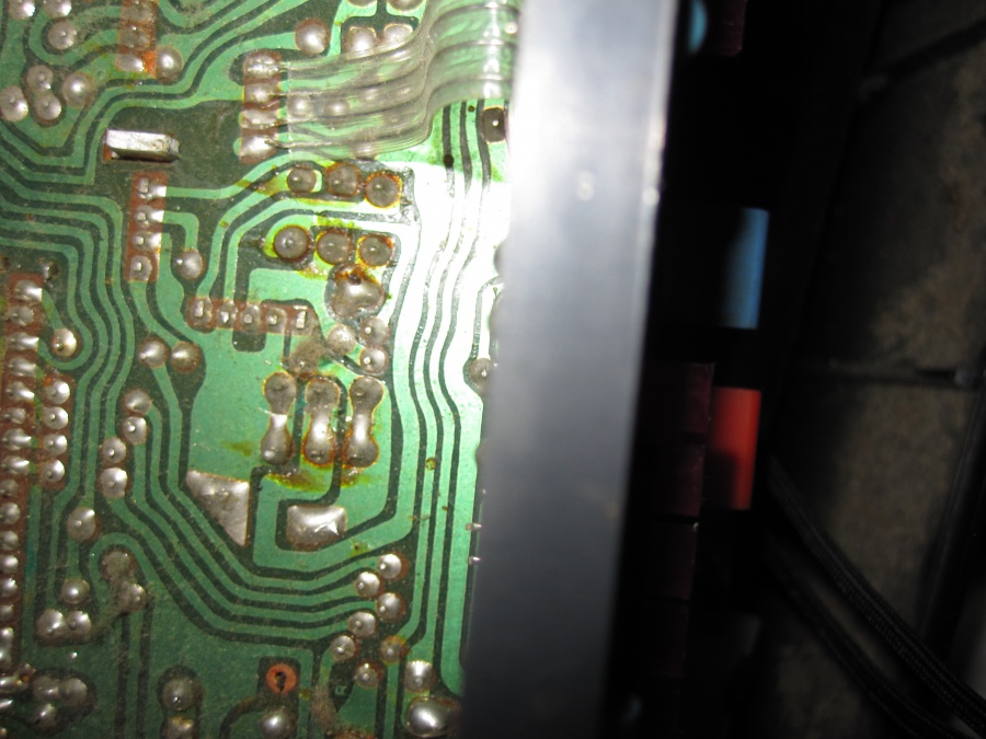

Power switch casing/body. Left is 'On / Off Sleep' right is 'On / Off'
Power switches on board. Top (blue switch) is 'On / Off' Bottom (red switch) is 'On / Off Sleep'
Close up of switches with better view of traces. Top is 'On / Off' Bottom is 'On / Off Sleep'
Power supply. I removed it yesterday and didn't notice any physical abnormalities.
Wow. THAT is one filthy boombox. The first thing I would do Johnny is take that out to the garage and using a shop air compressor, blow the heck out of it.
OK as for the capacitors, that residue you see looks more to me like contact cement. Large capacitors frequently are glued down to prevent their mass/weight from damaging the circuit traces they are soldered to from cracking or separating from the PCB.
As for the power switch, those looks like standard DPDT switches to me. There are 2 poles. In other words, each row of three pins represents one pole, and control one circuit. Sometimes, the two poles are bridged (such as the bottom switch) in an effort to double the current carrying capacity (it would be like 2 wires carrying current instead of 1. The center pin (among the 3) is the common and will be latched onto either the first pin or the last pin depending upon the switch position. So if we arbitrarily assign the switch positions as Position A and Position B, then in one position, the common (center pin) will have continuity with one of the other pin, and in the other position, connectivity with the second pin.
So with boombox disconnected from power, set your meter to the ohms scale (you want low range since you are expecting 3 ohms or less) or continuity, then probe the pin pairs as shown in the picture.
Basically, if position A is reading low ohms, position B should read high or infinity. Toggle the switch to the other position. Then retest. The readings should now be reversed. You can verify by toggling the switch with the probes connected. You should be able to cause the readings to change from high (infinity) to low (almost zero) at will by toggling the switch. If you are not getting the expected readings, then your switch is bad.
On the upper switch you'll need to test both poles separately. The bottom switch has the 2 poles bridged so you only need to test the single pole.
So this test here will help you to either find a bad switch or eliminate it as a potential culprit. Also note that you are looking for very low ohm readings. If you are getting high (anything more than a few ohms really), the contacts are likely burned/pitted and the switch can't be saved.
