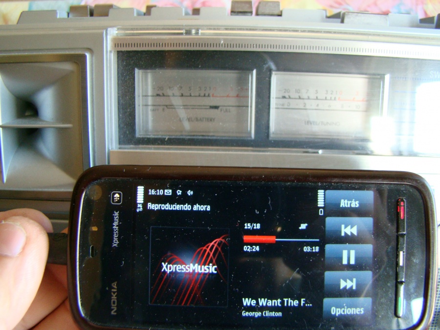

I have the same problems in the line in, plug in my cell with a din cable and not sound , press repeatedly rec / play and achievement have sound only in the right channel ,whithout bass :-/ y try to cleanned the swicht have if that solves the problem,
the line is in operation without being in the rec function? that is correct?
Any help ,thanks!

clear the rec/play swicht solve the problems :-) ,now get sound ,but only if rec+play are press :-/ is nornal on a euro(m70-L) version? ,I'm using a mini jack / din one with 3 connections, will try to test one whit 5 as soon as possible,be if that is the solution.

Thanks mmcodomino ,for explain the correct funtion , as kenpat said, I probe with a phono / line adapter and works, not as loud as the line, but is cheap to find a "USA model :lol: :-P :lol:
somme pics of the of work later today
