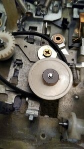

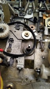

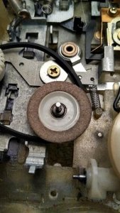

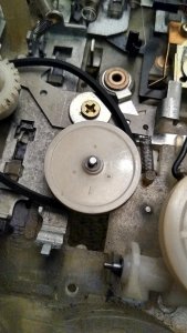

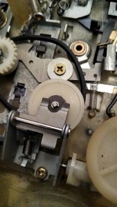

I'm not sure if I assembed the clutch correctly. When PLAY is pressed, you can still notice the clearance between metal lever and lower plate, by moving the reel towards the lever. The lower plate turns but the shaft stands still, so lower plate is not connected with upper plate. Do you have any photos of what elements should be mounted in the clutch, that makes everything tight? That would help me a lot. Metal clutch lever is mounted correctly.
current assembly, starting from top:
0. Clutch lever
1. C-clip
2. Bushing
3. Little bushing
4. Upper plate
5. Lower pulley with lining material
6. Reel with shaft
Is this correct?
Have a nice day!
Damian.
