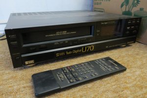

Hu,Nice Panasonic! I have a Mitsubishi HS-U760 S-VHS unit I bought new around 91’ or so. Really loved it until the transport section won’t load right anymore,needs to be serviced and I’m not to good with those loading decks. Great looking unit!!😎📺

That's a nice story transistorized. My dad gave me his old Fisher receiver he was about to sell in a yard sale, before I said I'll take it.
And I actually also bought a Mitsubishi U70 on e-bay about 4 years ago and she said everything was working....I tried it on a new TV and it was all in black and white only. So it sits upstairs in the attic.

My dad has used an SVHS Panasonic deck like Goodman has, an AG1970 - excellent top of the line deck. I also acquired an SVHS Mitisubishi deck like Coast Steve has from a friend. Seems like these have similar problems - my transport and electronics do everything they should do except display a picture!! OSD works, transport works, but no picture or sound. Maybe control head? Anyway I digress - best wishes to you and your dad - Cheers! Bellarmine
