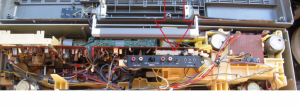

Like Dave explained above you can clean the long record bar switch indicated in the pic with Deoxit. Squirt it from both sides of the long record bar, the holes you see from the front and manually push it from one end (the right side) at least 30 times. The bottom of the switch is closed fit to the fiber board holding connections on the slide contacts inside. You have to get Deoxit inside through the hole on the metal part, or from the ends of the switch to get the deoxit inside.

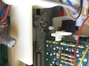

It looks like the video I intended to attach at the start wasn't attached. I'm sorry, here's a google drive link. It hopefully makes the problem much clearer.
I opened back to have a peek- though must get some Deoxit to do what @BoomboxLover48 suggested.
Two things stand out. Photo one: Compared to BoomboxLover48's photo it looks like some plastic latch is missing. And from what I can see here the white vertical plastic cylinder looks like it should be held in the metal U shaped clasp next to it. Or something should be, else it's a piece of redundant design which seems unlikely in a box like this.

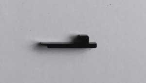

Photo two: The other is this small piece of black plastic that was loose inside. Anyone know what it is or where it came from? It's about 1.5cm/0.5" in length.
