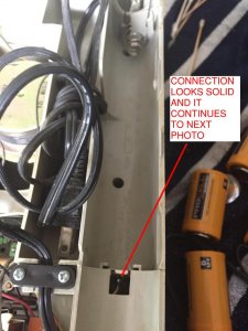

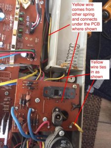

I cleaned the springs / contacts. This unit has a permanent power supply cable coming from the back of the box, so it doesn't have that small battery shut-off button which units that have a removable power supply cord do. I suppose this is the reason for the AC/DC switch? I've tried the batteries with switch on DC (and even AC), and no luck.
The wiring looks to be fine, and I traced the routing, which matches photos of other 920s I've seen online.
Does anyone have any advice?

To be sure, you can use a digital multi meter on continuity test with a probe at one end and one at the other to ensure there is continuity. This is always a good place to start because it either shows the fault up immediately or quickly eliminates it so you can move forward with focusing on the next area.

That last picture I see the barrel plug DC adapter connection. Almost 100% sure that the contacts on that are dirty. With the switch slid to DC if a wall adapter is plugged in or car cigarette power adapter, it terminates power from the batteries when that side leaf inside that barrel plug adapter pushes outward to make room for the barrel plug. When it does this it kills power from the battery leading to that adapter and uses the wall adapter power instead.
My advice. Spray Deoxit in that barrel plug. Insert a proper sized (non powered) barrel adapter plug in there to work the contact leaf switch. Push the adapter plug in and out a few times to help clean it. Then see if it doesn't come to life with batteries after that.
It could be the DC switch but again, I have run into so many radios that the adapter plug terminals were dirty and wouldn't allow voltage to pass it to feed the radio.

Thanks guys. I will clean the switch and break out the multimeter!
I didn't think about cleaning the switch and it does look dirty. It's something that should have come to mind, since all the pots required a good cleaning.....

Thank you. Cleaned the switch and DC connection and I got her running on Batteries. Yee!
