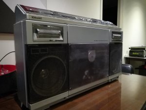

Yes! Picked up this beauty! Working condition but needs a service and belts.. Another project to work on.
Hopefull if all goes well, by the end of this week Ill have 2 VZ2000s. Black and red! Definitely falling for the VZs
This is soo addictive. Spending all my time reading through this forum, online 2nd hand shopping sites and weekends going between thrift markets

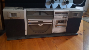

Picked up th black 2000 last night. Bit rough in condition... But it should come up pretty nice with a bit of work
I love how big this box is!
