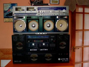

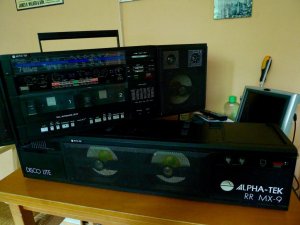

This box just arrived yesterday evening and has me scratching my head, It's a two piece disco lite box. Quite well made with thicker plastic than usual and a snazzy touch cassette deck. It was well packed so nothing broken however it is missing some bits. A piece of Perspex which covers the main controls and a ribbon cable which powers the top from the bottom section I think. I also don't know how the top attaches to the bottom permanently? I don't know anything about this box apart from the info on wikiboombox. http://www.wikiboombox.com/tiki-index.php?page=Qualimax+MX-9+discolite
The only other one I know of is a nice example that DR DER has in Cali. Any information on this would be great as only the top section powers up.
Wish me luck on this one........
It's a big old girl by the way!

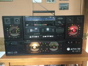

Wow! With light up speakers too?!

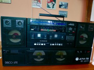

The main unit connects to the lower speaker section by use of angle brackets.. They screw into the sides of main unit, and to top of lower speaker unit in those recessed rectangular pockets.. The side speakers unlatch and slide up from main unit..
I believe the cable from main unit goes from the bottom into the top hole of lower speaker unit.. This box is pretty simple to take apart, hopefully this helps

Its a huge and unique box. I've never seen one with flashing dust caps like yours though. Very cool. I'd love to see it all up and running, congratulations ;-)

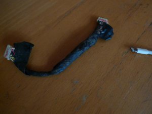

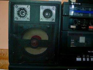

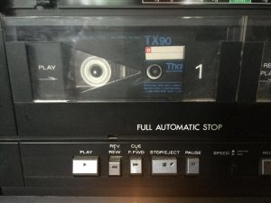

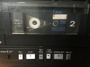

We managed to build another ribbon cable and got it to power up. It briefly played on both channels for a bit and sounded good. The power switch (top) is dirty........in fact all of the controls are touchy. Three of the woofer lights are blown. Surprisingly both decks work!
Found another lead in the packaging this afternoon so will figure out where that goes.

Member SLO had one of these, I think Dr DER has it now. I worked on it, what a MONSTER. That thing is an analogue computer!
It uses a series of cables and brackets to tie it all together. Certainly nothing your going to casually take apart.
