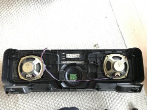

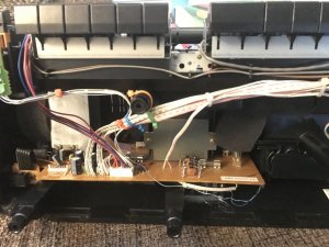

In case the 3D80 is not going load you need to replace the caps on the amplifier board.
They dry out on these models.
I have 2 3d88 which have the same electronic boards and suffer from the same problem.
Even worse, the 3d circuit does not do next to nothing and the left channel is much louder than the right on.
I will do the replacement of the caps on the weekend.
From my point of view there is no need for other speakers. That would be (too) pricey compared to the value of the 3d80 - anyway the existing speakers are not bad.
I also added some foam material in the back of the body in order to close the body a bit (see pictures).

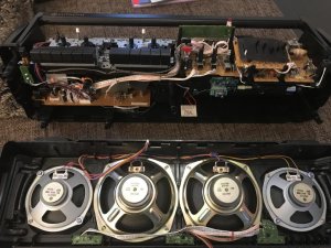

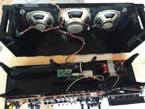

Those 4 speakers do look a little weedy...............Attached File  IMG_3954.PNG   591.21K   11 downloads
When compared with the original 3D7 speakers:Attached File  IMG_3949.PNG   706.29K   14 downloads

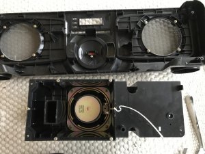

To complete this Hitachi Speakers excursus, see some pictures from TRK-7620 and CX-W700, which features a bandbass enclosure for the subwoofer. That leads to really low frequencies, however only at ambient volume level indoors. Once you pump up the volume, you have to lower the 3D level.
Regarding the volume level of the TRK-7620 / 3D7 it is very similar to a bose soundlink mini.
I would expect the same from a 3D80/88 however so far I did not get a 100% working one in my hand.

Always love it when they build a proper enclosure like that CX-W700. Stuff a bit of fiberfill in there and I bet it would slow down the waves and make it even warmer.
#17 Helmar
Helmar
  • Members (SA)
  • 59 posts
  • LocationHamburg, Germany
Posted 29 June 2017 - 10:15 PM
The construction on the CX-W is a helmholtz resonator, not an absorber. Using fiberfill could be a trial and error operation. But this is a different topic.
