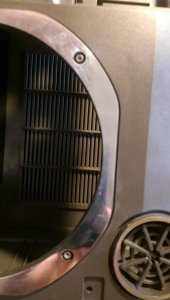

As you can see in the last picture fake chrome took its toll too!
Unfortunately on this this box you cannot take anything out so i have to repaint them also!
Any ideas on how to do that and what kind of chrome colour to use?

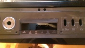

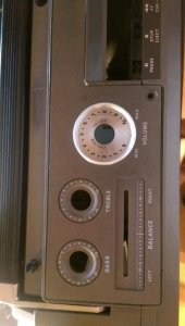

Ok the project is back on with a sanyo i want to mini restore.Here are some pics of the fogged plexiglass and tape door.
since i am going to paint all the box and maybe leave the gray lettering on the top/front cover glass alone i am looking for solutions on painting the tape door and defogging the glass part inc the tuner window plexiglass

For the tape door, I would recommend getting some chrome or diamond-plate vinyl tape off Ebay, and cut it to shape.

The clear plastic window surely seems like it cant easily be removed for defogging. Can't remember how it looked like from the inside. From the front it looks like it has tabs holding it in place, but IIRC, those tabs were molten to the front face from the back side.
I washed my own window with some all purpose household cleaner + water, but then it had moisture in there. I got it out with a hair dryer or a hot air gun (at low temp). You could also try those silica gel bags that come with many products in their box. Put the front face and a couple of those silica gel bags in a sealed bag and let them do their thing.
Also maybe a mix of purified water and vinegar could help getting out any residues from the window.

The tuner window on this model is low-quality, just like the one on the Sharp GF-9191. It gets yellow and hazy very easily. I use Turtle Wax Scratch and Swirl Remover.
