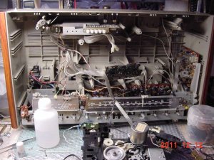

Use a small flat head screw driver to turn the trimmer to adjust the speed. You just introduce the tip, go straight down and feel for that slot on top of the trimmer.
I have marked the inside head of the trimmer for speed adjustment with a red arrow. This is the part you reach inside through the hole.
The width of the screw driver tip should be around 3.0mm. Tip thickness like 1.0 mm.
You can see the motor back side showing the black hole covered with a cross hatched rubber dust shield.

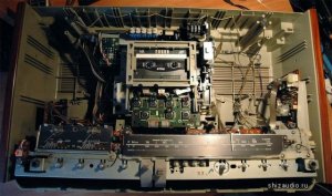

Here are a few pics I found on the net for reference purpose. If you search for images for RX7000 you can find many of them.
Watch the tuning cord and the axle of the pulleys through which it is run. be careful not to break it. Also cover the dial with a layer of clear plastic not to get scratched when you take the motor section out. The tape transport key button assembly with the cassette section all should come out together so that you can take it out, turn it to one side and lay it, then adjust the motor speed while it is working. I hope those connector wires are long enough to do that. You can see it all in the picture. Hope this helps! Good Luck!
