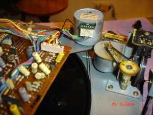

I played with the tone arm wheels system by hand to understand how it was working but I went too far and actually bended the switch ,it was during the first day of the restauration... I somehow with a lighter rebend correctly the switch spend 30 min looking on the floor for the little copper piece that fell off and put the switch back in position. The thing I didn't notice was that now the tone arm system had gone too far after the switch that indicate the rest position !
Here is a picture of the situation before fixing the arrow point a piece of the wheel that should be on the right side of the switch but there it's not !
So I simply took the switch off turn the wheels backward a little bit, rebelt and miracle I have a fully working VZ 2000 !
