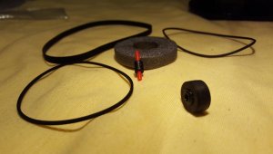

Thought I should end the thread with some finishing photos.
Here is the completed unit once fixed and fully cleaned.
I have attached two further photos showing:
- The parts I have replaced. Interestingly, on my unit the idlers tyre came out almost intact, but it was obviously deteriorated enough to be one of the problems. The original still sat nicely on a WD40 straw and had not started to turn to goo, but it was very misshapen.
- One shows the original pinch roller that came from the unit. I am pretty sure the unit has not been apart before, and so all of the internals would have been originals.
- One photo shows the new pinch roller in place (at the moment of final success), which i think shows the replacement roller I purchased has a much bigger spindle (and smaller tyre), but despite it being a fraction smaller, it works perfectly. I think the photo also shows the retaining spring which adds pressure to the pinch roller.
