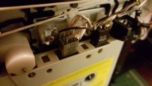

Mode selector not working properly (thanks for the cleaning tip!). Doing that made some sounds come through the speaker, but only static. So I figured out there was an issue with the tape head alignment, it did not go down far enough for it to make contact with the tape.
I did a rough fix on that (image attached) with some aluminium foil and re-aligning the screws. Tried this 40-50 times and seems to be holding up.
I will make a proper fix once I get back in the shop.
Thanks a lot for the help! So satisfying getting it working.

Wow,that's very nice to hear and see. Thanks for the updates and pics heeron.Do let us know of your final proper fix. Some more pics of your boombox both inside and out would be neat too. Also stick around and become a regular here on our happy little site.
