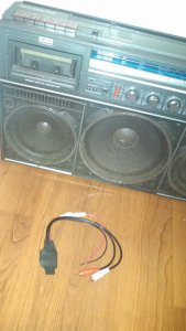

Hey gang! I found some time for fun. I rediscovered this 12v bt dongle in a toolbox,and am ready to use it.
I saw a thread about adding it to JVCs,and am wundering if anyone completed this model.
I have some time,but not alot.
Seems simple,but the RCA jacks on this model suck. Maybe override a SW radio?
You guys are all friggin' geniuses,so I like to ask before I start wrecking stuff myself. Haha
It's a beater box,but still a sentimental model. If it works I'll move it to my daily work D8443.
Thanks guys!I couldn't have any of this fun without you all.

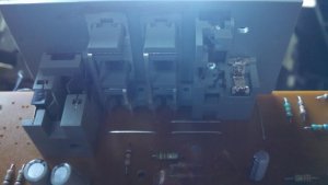

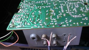

The backs of the RCA jacks are different than others. I can't see the paths to follow.
And my laptop with the manual I downloaded years ago is dead...
Anyone got a manual? I see lots of requests for it but no replies.
Heres pics of the RCA backs.

Tuner board: LINE OUT
Main board: LINE IN
Main board: POWER + 12v - power bluetooth module

It looks like by adding this on/on switch,
will cut the radio and activate power to bluetooth,while the boombox is in radio mode(power on).
Is that right? That would be good.
Is that right? That would be good. I appreciate the help.
Yes, its right - when you in radio mode:
push button ON - bluetooth mode.
push button OFF - return to radio mode.
When you start this mod, please make pics.
Check with digital voltmeter for +12 v and ground,
before make connections, to avoid mistakes.
