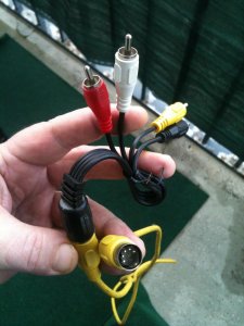

Here is a picture of the DIN connector at the unit (called REC..) and also the adaptor for Cinch I use. the white and red Cinch are for playing while Yellow and Black would be used for recording on an external unit (Line Out).
The color change in the picture at the DIN connector of the M-70 looks strange, that is why I did change the picture (brightness of that area) so the 5 connectors of the DIN can be seen better.
So I understand that it is regular that you have to press RECORD at European units in order to hear the Line In Signal. I think an electronic specialist should be able to make that work that setting the Source switch to LIne-In would automatically switch the other contact so pressing REC is not necessary anymore.
