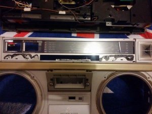

I have a M70 apart but can't for the life of me figure out how the tuner number display plate and the tuner light plastic panel bits come out...
Cheers

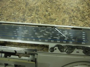

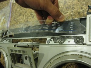

Not sure what's the correct way to remove it...but this is how removed mine...
  • I first removed the needle dial at this spot and turn counter clockwise (first pic)
  • Then I slide the number diplay all the way to the left and bend in the middle and I get the right side out first (second pic). Just be careful when bending the number display.

yes thats right
the reason you may be having trouble is I can see in the photo
you haven't removed the thin aluminium strip on top
This needs to be removed then the needle and then the scale
will all pop out

nikonfoo said:
yes thats right
will all pop out
You're right....I missed that...I did not see that other piece.
RockE
Apr 13, 2011
199
53
Australia
ok cool thanks guys :thumbsup: , I thought somehow it may have slid out from behind.
Bending it like that didn't even occur to me :bang: , bending hard plastic usually = snap!
I hope this helps :thumbsup:
Got it out, pull it up in the middle a little!, unclip the two clips one on the left and the other middle ish of the plastic bit then slide it to the right it then just comes out real easy slide the black bit the right too. Only had to lift it half an inch if that. :)
^ exactly how I do it too. Seems like the wrong way to do it but there is no other way! ;-) And as nikonfoo stated, you need to carefully pry that little aluminum scale off first.
If you are nervous at all still, you could always pull out the trusty hair dryer and warm it thoroughly first.
