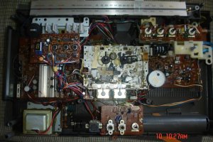

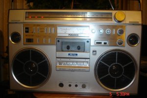

I have a Hitachi TRK8600.

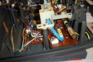

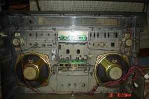

I believe there are locking points across the edges of the cover! I opened it up an year or two ago.
When you open it the plug connecting the deck controls will pull and pop out. It is such a pain to put it back. We need Santa's little elves to put it back. I struggled with two fingers to lock it in place.

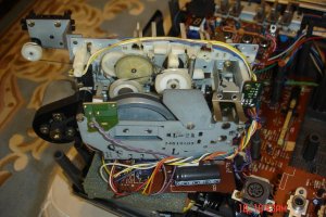

Hey BBL do you have a pic of the way the belts go...I replaced them the way the were already fitted but yours looks different I think?

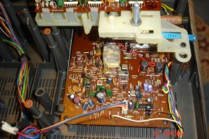

The third pic from top shows the connector I am talking about that is hard to put on when you close the unit. You need to hook it to operate the deck feather touch buttons. :-D

Yeh pretty sure the middle belt didn't go like that on mine, I'll have another look, thanks :-) There was a casing screw missing so maybe someone had already been in and messed with it
The connector to put the deck buttons back wasn't too bad to put in on mine.
Thanks for the pics, really helpful :-)
