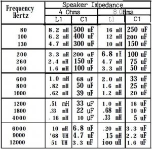

wolff3012 said:
That GF 9494 is a great box, sooo easy to open and now with line in... awsome !!!!!
The sound... woooooooow. Ive chanched the cap from 2200 µ to 8600 µ...
Do you mean you changed the tweeter (audio frequency capacitor) passive crossover NP cap? How many ohms are the speakers?

noo, sorry... not for the speakers. (the tweeters cpas have 4,7 µ)
I mean the power cap near the amplifier. The lamps flashed a lot and my idea was a better cap... with that its a bit better. 2200 µ -> 8600 µ. And: why not ???... :- ).
