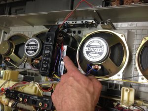

Ok guys, the unit is very clean on the inside, all switches and knobs work perfect. Here is the culprit to the off and on buzz static sound. A light tap will make it come or go. Its the silver piece, I don't know what it is Im sorry. It doesn't feel loose and haven't found a broken piece yet. Anyone know what it is?
That looks to be the heatsink for the amplifier modules. Could be the amp modules have poor solder joints, or the internal connections (from leads to internal circuitry of IC) is fracturing. You can try reflowing the solder joints to see if that will help, and if not, you may need to replace the chip IC. It would be the Hitachi HA1392 module. If you change the module, make sure you restore new heatsink compound.

Wow you really know your stuff thanks! I will check the joints. If I should need to replace these modules, where does one find a replacement? At this point touching aluminum which I gather is the heat sink seems to be the trigger. Hopefully I can narrow it down to a weak joint.
That heatsink would be grounded usually and probably via a screw. Losing it's ground could cause it to collect interference to the chip. If the chip is bad, you can find replacements usually on eBay or through the web. It's an obsolete chip and only NOS (new old stock) remains. If you are unable to find genuine Hitachi replacement chips, you can try the generic replacements NTE chips. They make quality products but compatibility is not 100% assured, especially when the chips are operated in bridge mode (the ones in the GF-777 are not). Try here:
http://www.weisd.com/test/GenericParts_WEISD_view.php?editid1=HA1392
IC's, over time and through frequent heating/cooling cycles from powering on/off, the internal connections attached to the external leads fracture. The rate of such failure obviously depends upon how the unit was used. If the poor connection is due to loose heatsink screw or poor solder joints, it can be repaired by retightening the screw and reflowing the solder joints (add a little fresh solder too). If that doesn't fix it, then the internal lead fracturing is highly suspect. Each of those 2 heatsinks control different amp pairs. One pair powers the inside speakers and the other pair powers the outside speakers.

Ok, here is the latest update. I checked and cleaned the connections, repaired the loose power switch using the hot nail method I found here on the forum, :thumbsup: put her back together and enjoyed a day of static free listening. Unfortunately she is back at it. :thumbsdown: So I am going to try to resolder the joints on the lower of the two heatsinks. this one powers the sub woofers I figured out. I am however, not going to attempt it until I practice my techinique on a less valuable piece of electronics. I have done a lot of solder work in cars for audio/video installs, but not on anything this intricate. Can anyone recommend a good solder iron for this application? The gun I use in autos seems too big.
