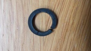

Hi there, I just got a used Hitachi stereo radio cassette deck on a flea market. The radio is ok, but the player is eating cassettes. The fwd and rwd functions are ok, but when I hit "play" the roller does not drive the cassette forward.
I opened the player and out fell a small rubber ring (see picture). Is this the problem? How could I get a replacement ring and where does it belong?

Looks like that's the problem. Without that idler, the capstan will pull the tape across the heads, but the take-up reel won't wind the slack. You might be able to use an o-ring from the hardware store as a new idler.
If you're going to repair it, order some new belts and check the condition of the pinch roller. If the pinch roller is O.K., give it a good cleaning with some rubbing alcohol.

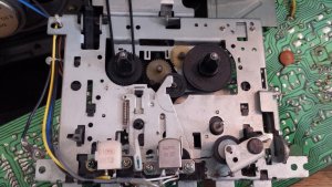

Thanks, but I am not sure where that "idler" should be placed? Please have a look at the picture.
The belts look ok, but they have some slack....should they be tight?
I get the "roller" to go forward without a tape and when I help it a bit, so the other functions looks ok since I get sound from the cassette.

You'll have to remove the deck to access the idler pulley. I'm not familiar with the model, but it looks like it's fairly easy (as far as decks are concerned) to remove. It should be somewhere in the area I highlighted on your photo, but on the opposite side of the deck.
As for the belts, it's not a bad idea to just go ahead and change them while you're in there. They're pretty cheap, and you'll have peace of mind knowing that they're fresh. Someone here might know the belt sizes, but if you can't get the specific sizes, you can order a variety pack.
There is a seller on eBay from P.R. that sells 20-30 piece packs for an excellent price, but he only ships to the U.S., so if you're not in the States you may need to look elsewhere. Belts should have enough tension to drive the pulleys, but not so much that they bind or need to be excessively stretched to install them.

I believe you have to unscrew the cassette player so you can access the front . On the front unscrew and remove the transport plate. That should expose the idler wheel and forward/reverse pulley/wheel.

Hi, thanks. This is a picture from the other side. Guess the rubber ring will fit into the small black wheel. Unsure of how to fit it around, but I have to get a new rubber ring first.
That is the one! That is what member superlew was talking about!
If you go to hardware store you can buy assorted "O" rings and one should fit it. Or else measure the inside diameter of that broken idler and get one that fits the wheel.
You should be able to slip it under the arm and get it there. I don't know how much clearance you got there.
