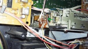

This is the only picture I have inside my 2nd edition. What a tangled mess!!!!
Probably won't help :-/

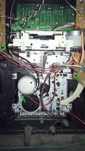

Okay, hope this helps, looks like the black goes to the left post on the motor, one wire to the upper deck, one wire to the bottom left corner of the right board... Here's pics.
Good thing I took mine apart, my 110/220 transformer or whatever its called, is just flopping around, stuck to the magnet on the woofer!!! gotta fix that.
Hope it helps!!!

Yes! That was it. I saw that pad had disconnected but wasn't 100% sure.
Got it reconnected now, it wasn't an earth though. That wire has something
to do with the LEDs that denote the play direction on the top deck as mine weren't
lighting up at all till it was reconnected.
Thanks a bunch, Bill!!
