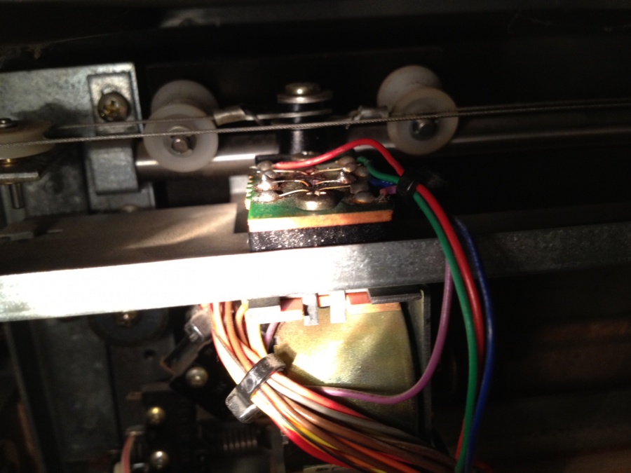

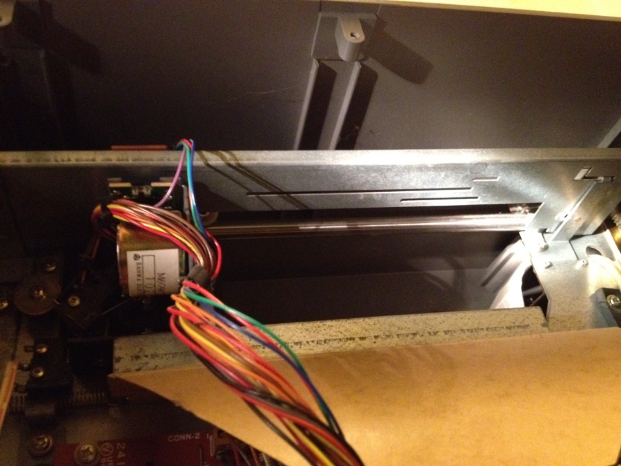

here are some pics.
Presenting the linear tracking system. You can see the tonearm ascend/descend motor and the metal plate with the guide slots.
Here we see above the metal plate where the LEDs are supposed to be; they are pretty burnt out! Sadly the heat from this LED fire left a warp in the top of the unit.
And finally the sensors below, they appear undamaged. It's all starting to make sense now. so; if I replace the LEDs it should potentially work again! I love fixing things!
Question: What size LEDs ought I use? Little ones? Regular size ones like in a VU meter?
