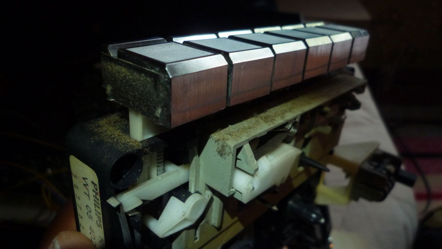

Part 2 - inside of the box
The device had been with a smoker, it smelled quite strong, old tobacco.
There was some dirt inside, seems like it has been opened at some point.
Traces of wiping dust off the bottom. I think the spider chose his place a little badly. He wasn't there no more though.
If it wouldn't have been opened in any point, I can just imagine how much dirt there would have been...

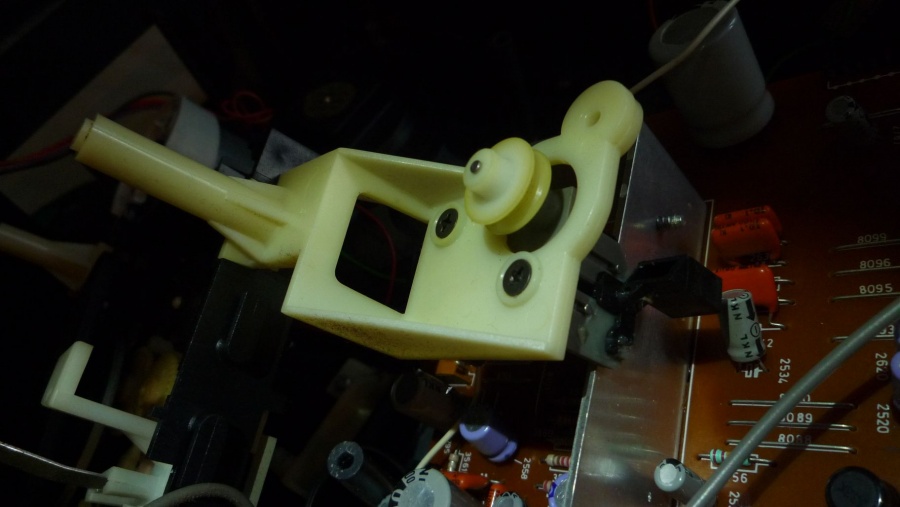

Some random pics
Deck door has jammed at some point, there is some marks on the sides of the door and on the opening mechanism
Motor and date

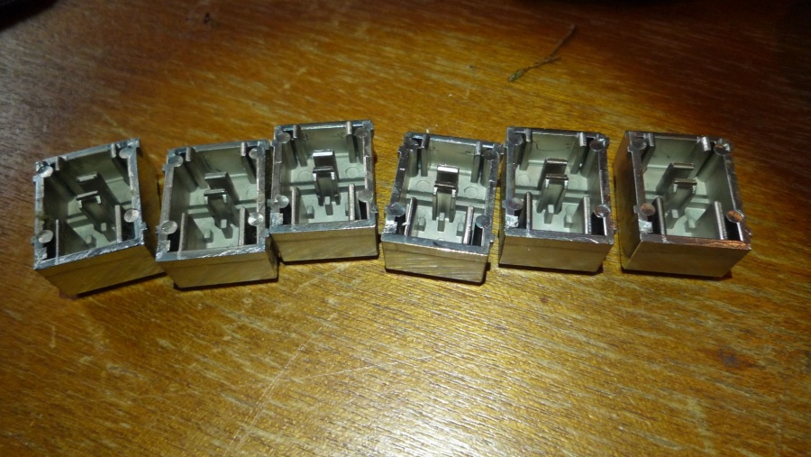

Part 3 - cleaning

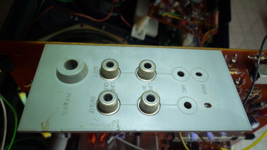

Side connector panel before/after
didn't polish the connectors, just a normal cleaning
Deck

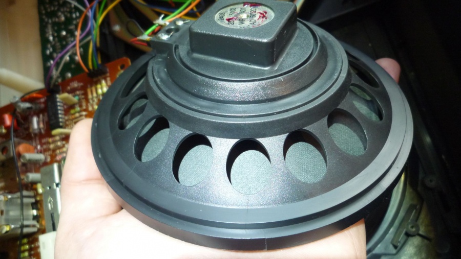

Speakers
These had some dust on them and the dust covers were dirty. I used microfiber and APC on them.
Left speaker...
...had some spatters on it
Right speaker is now in mint condition

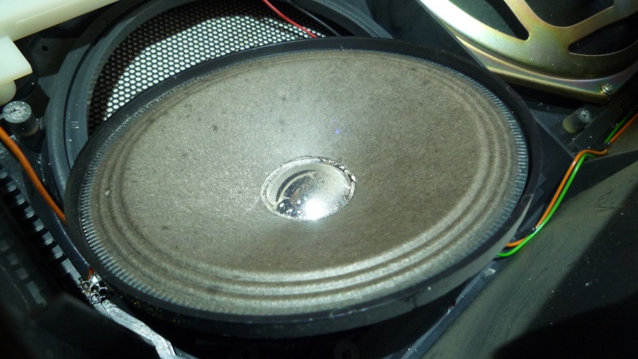

Woofer was very dusty
I used toothbrush for the excess dirt
Then I found out that the shiny "topping" on the surround had lost its shine under the dirt. I took 100% silicone oil and put it on
Dust cap cleaned
Here is the finished woofer

The midranges are a low cost "light weight" -line with plastic frames and very small magnets. I have one black DUX that has same kind of speakers, just smaller. No bass whatsoever, only "meh" midrange and some highs.
The woofer on the other hand "radiates" quality. There is the AD80800 M4S wide range (dual cone) model, that has got some good talk around the web. This is AD80800 P4S -model, not mentioned anywhere. But it is quality, thats for sure. Only thing I am a bit skeptic about the woofer is its xmax. When I tried the box with only the woofer connected, the sound got compressed/clipping really quickly. But I think its more a low power amp's fault.
