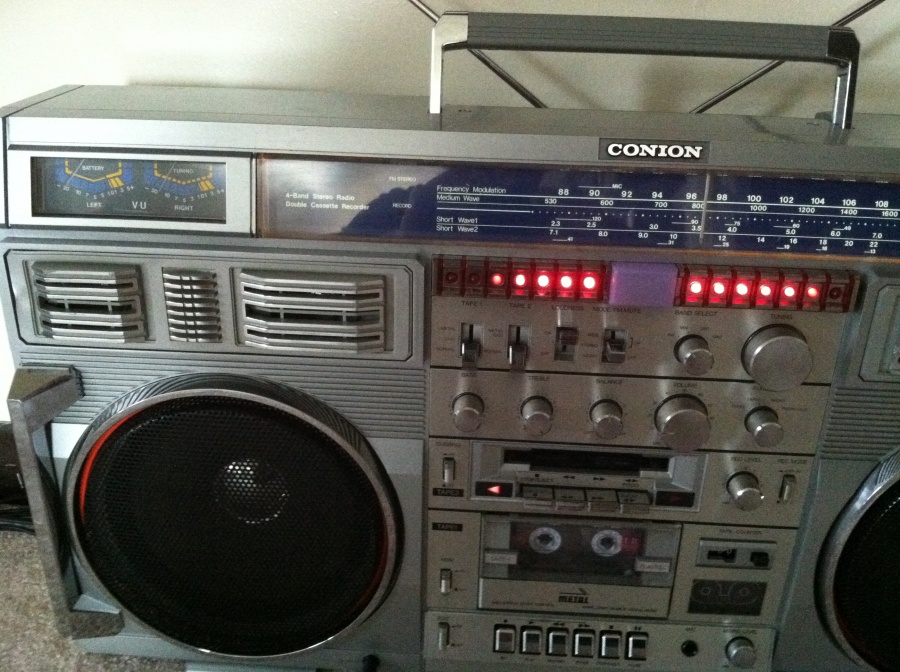

After finishing my Conion a few weeks ago, I realized I forgot to adjust the azimuth on the head on deck 2. I tried to live with it. I couldn't. I didn't want to remove the chassis again, no way, no how. Here's what I came up with:

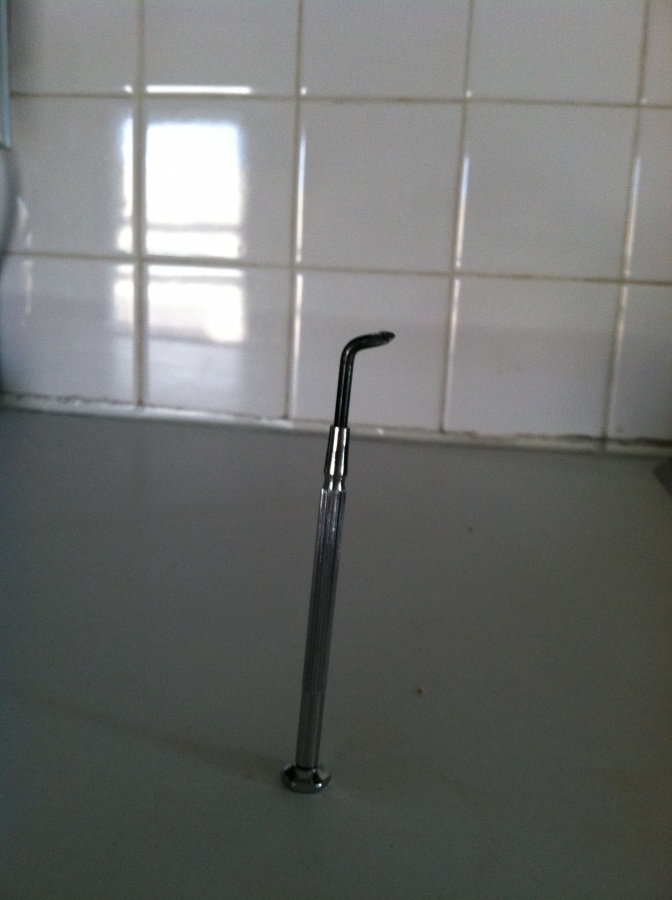

I did this with a sacrificial jeweler's screwdriver, a pair of vise grips, and a small pair of pliers. And Map Gas.

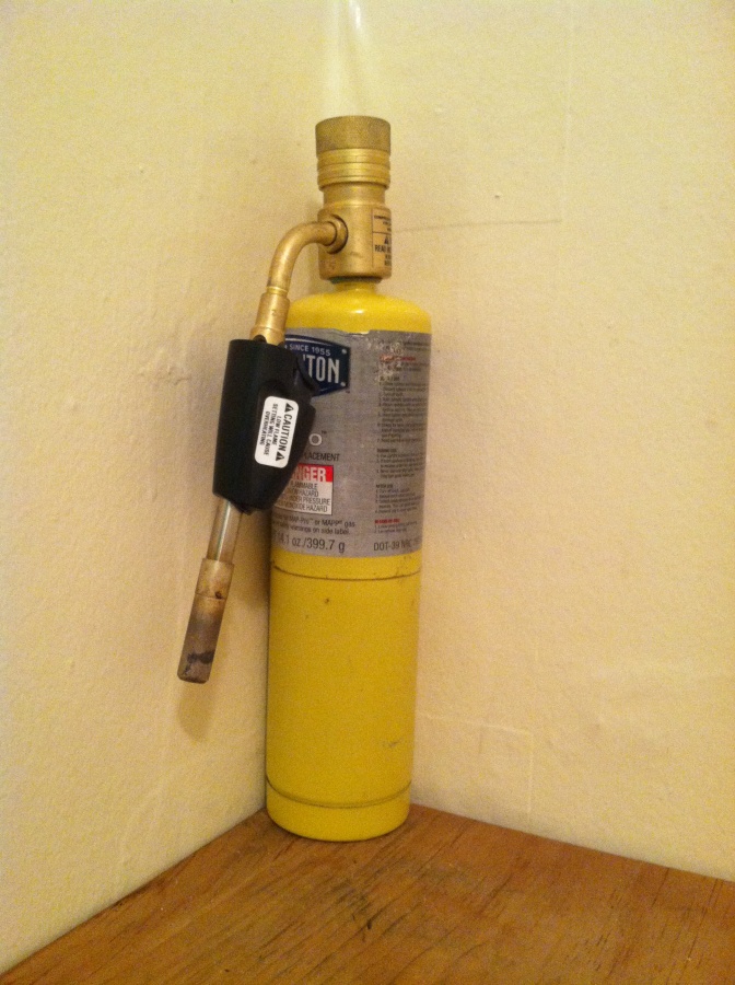

Since they don't make right-angle jeweler's screwdrivers, I heated the donor driver with the gas (propane is too cold for hardened steel) and gave it roughly an 85 degree angle with a 5/8" clearance. Just enough room to clear the head and all the other potential crunch berries in there.

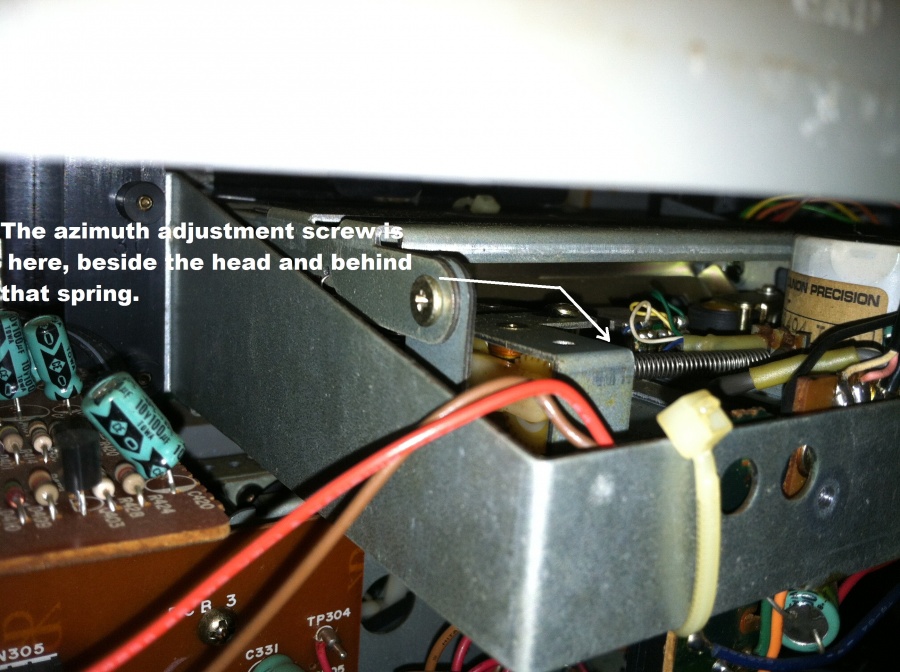

I made a mark on the adjustment screw with a Sharpie so I could confirm a 1/4 turn with each adjustment. Adjust, test, etc, etc.
Deck 2 now sings! :breakdance: Sorry the picture is lousy, but you get the idea. I figured I'd post this in case anyone else is having trouble with deck 2 and doesn't have the juice for a chassis extraction after a restoration. I didn't.

Here is the way I adjust mine. Easy as pie.
They have a hole in the Amp boards that allows you to adjust without making any new tools. Once you pop in a tape the screw lines up perfectly and is easily adjusted then.
I think this is the way they did it initially when put together as they manufactured it this way. I'm glad cause it would be a pain without these holes.

Ding! I just spotted the access hole last week in mine. I had to open it for a bad solder joint on a transistor that was giving me a nasty buzz in the right channel. I didn't have a #1 philips long enough to reach the head, though.
Hope this helps!!
It sure does! :thumbsup:
