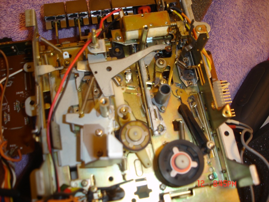

Hi Bill, I removed the deck assembly and took the flywheel out to get a better view. I can see that when the record button goes down 5mm there is an internal catch from the "buttons locking and operating assembly". This part is inside the two metal brackets that hold the movements of the deck mechanism incuding the levers, wheels springs and all. To tear down that bracket, It's a bear!! :yes: I used to repair clock and watches when I was much younger for fun. Now I am not fit for that kind of work, not anymore :sadno: :no:
To my great surprise it once went down all the way down and locked, but on a second try it is stuck again and will not go down. :'-( :'-(
If I look right above the play head I can see the little bottom tail of the record button lever coming down when I depress the rec button, so also the side lever is free to move the lever mechanism that press and turn on the record switch.
I'm pretty sure it is the problem is inside the little "buttons locking and unlocking assembly".
Please see the picture below:

next time you're working at it - could you maybe take a photo of the top back of the deck, especially of the AutoStop solenoid and the position of its spring? :-) That would be great as I'm still working on the problem, see this post.
Thanks

Oh Brother! I'm so sorry! :sad: I put them all back together yesterday. I gave up on the Rec button malfunction because I am kind of busy with work and had to free the dining table where I normally put a large card board, towel and foam to work on boomboxes.
Sure, I will take pictures of it when I get to this deck sometime. I feel terrible because I couldn't get the pictures for you. :sadno: :sadno: :sadno: It was left open for days and I was tired of spending too much time when I get little time in the evenings. :yes:

HI Dankaholic,
Good news! I took pictures of it when I was working on it. Just got it from my camera... :yes: :yes: :thumbsup: :thumbsup:
If you want the better quality pictures PM me with your e-mail ID.
