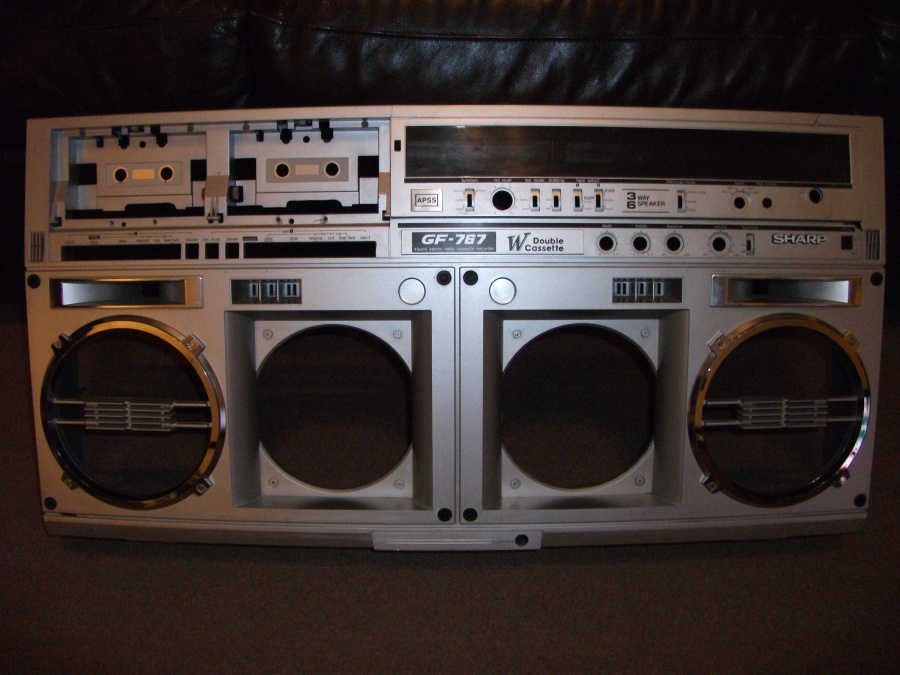

As the title says really, is there a way to get these off without breaking them :hmmm:

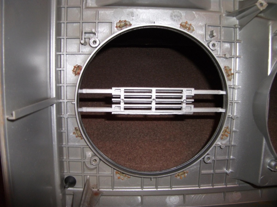

Looks like studs go right through the cas and are then glued?

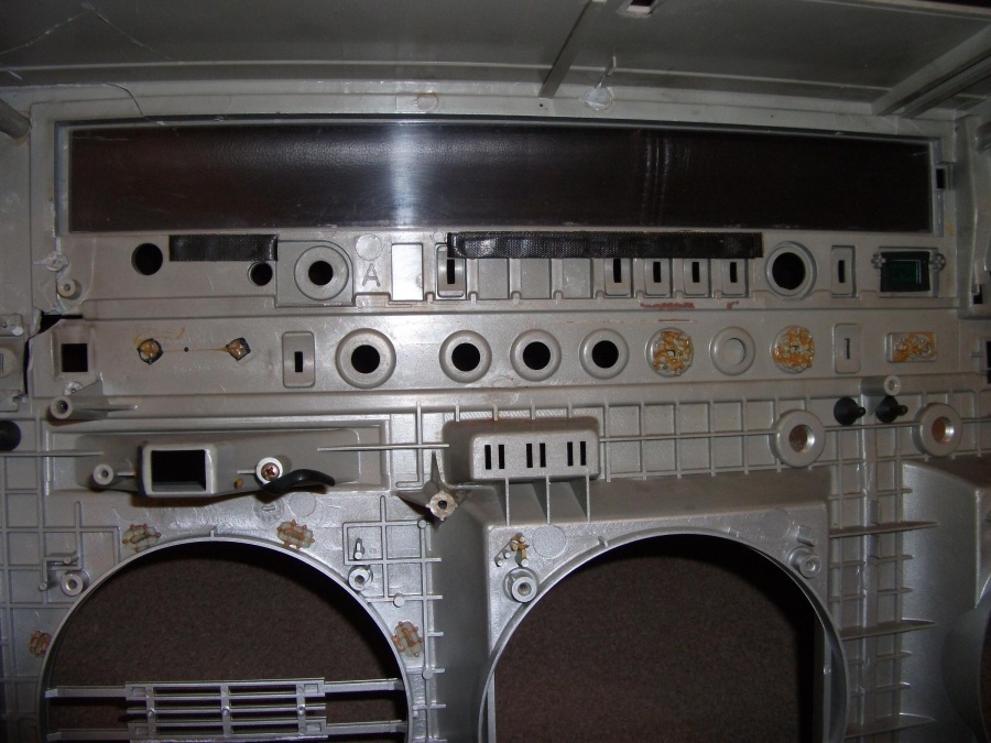

Also i noticed spaces for extra switches on the inside of case, is the front of the 767 actually the same as the 777?

the trims are melted to the frame , i used a dremel to grind down the welds and then using a flat screwdriver and a hammer punched each tab through until the trims came off , you have to use care doing this but it works great.

Of course, spaces for extra switches on the inside of case is the same as the 777:
