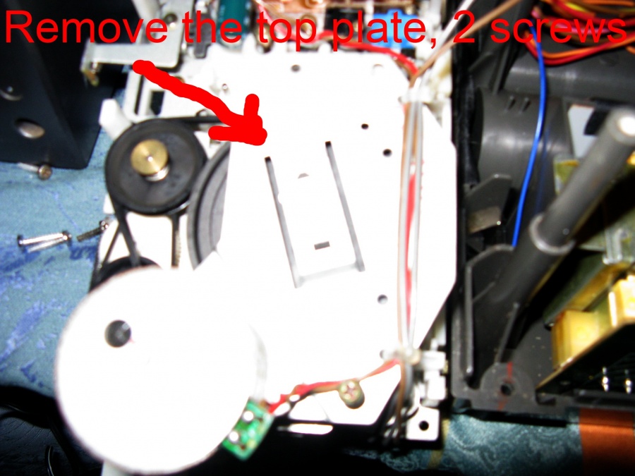

How to replace the belts on a Hitachi 9100*

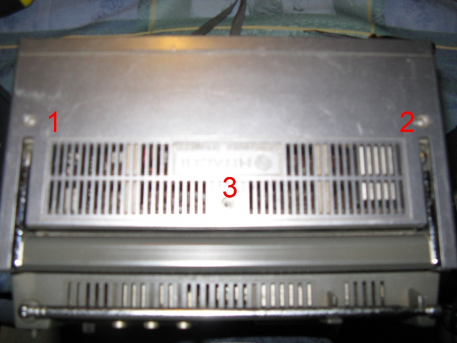

Remove 3 screws from the top of the box
Remove 3 screws from the back of the box
Remove knobs and sliders, open cassette door (separate both halves)

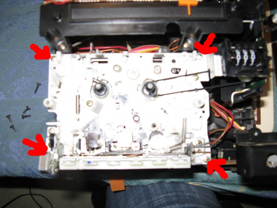

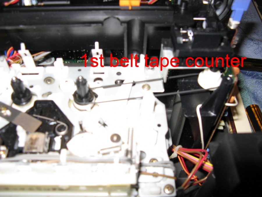

Tape counter belt
Remove these 4 screws and lift this assembly up and turn it over

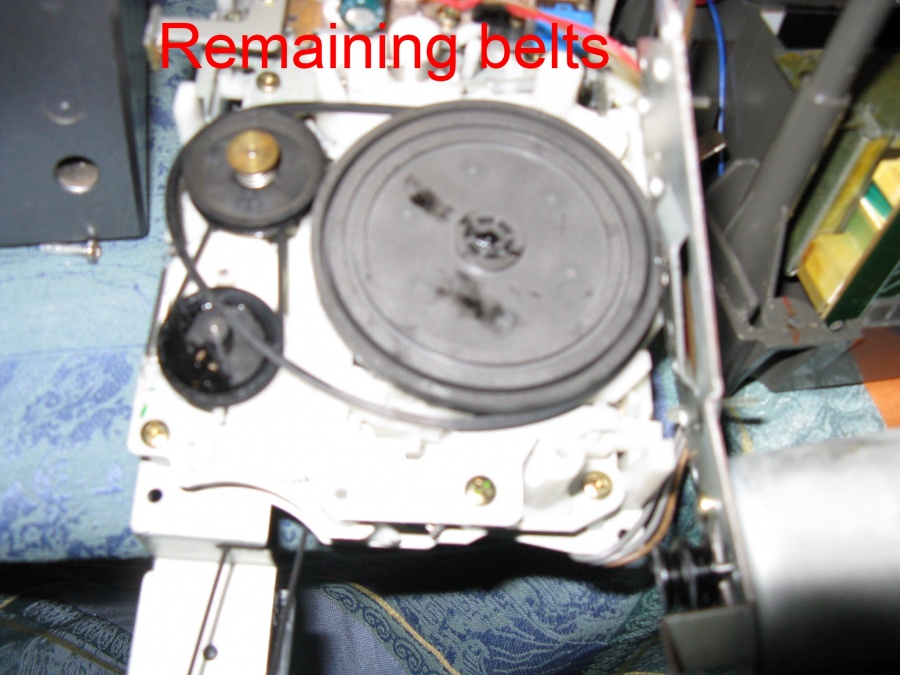

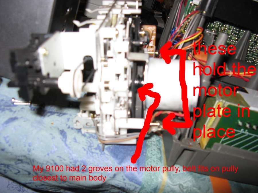

Remove the 2 screws holding the motor plate to the mechanism and turn it over
Replace these belts and clean up any crap from old gooey belts
Fit the the motor plate back into position and fit the belt onto the motor pulley, make sure the belts haven't fallen off the pulleys.
