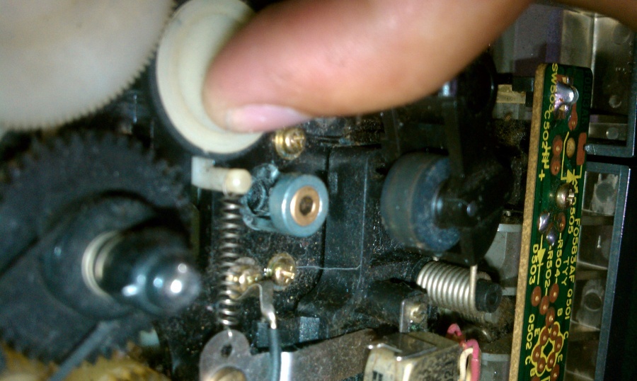

It could be as simple as cleaning your switches with deoxit and working them back and forth a hundred times or so, as for the deck a good cleaning plus rebelt and the Sharps also have issues with the capstain shaft tiny rubber wheel which melts after years of use/nonuse...see members Monchito pic :-D

Be worth checking that the motor hasn't seized if it killed the fuse when you pressed play. Just gently turn the capstan flywheel by hand and look at the motor spindle to see if it rotates.
